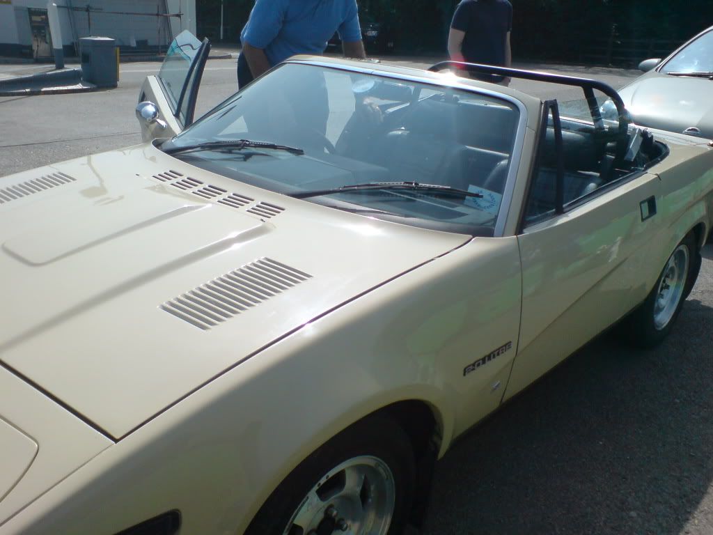

It was one of the main attractions to the car I bought - it has an Aley bar fitted. I feel it must stiffen up the rear of my drophead - it does however make hood erection slightly more difficult, and it then rubs slightly on the rear window. I've been meaning to make a soft cover for the tube - but of course there's never enough time !
I DO like the extra security feeling - although I feel it must take a lot to invert a TR7!

BMC, is that an Aley cage? I always thought that they were the 'double tube' type which formed a narrow 'A' with a vynyl cover(like mine if you can see it in the pic). The rear tube bolts down through the rear shelf either side of the tank and the front tube goes to the floor with a side plate which bolts into an existing welded nut in the side pillar behind the door. I am sure it does strengthen the car as I never get the shakes (mirror or scuttle) described by others despite a slightly crumbly and dubious core to the car.
I also appeciate the saftey aspect (which is why I have kept mine), but think the cars look better without.

I hate to spoil your "safety" talk here, but roll bars on "low-top" seats are NOT safe! They might help you if you experience a roll-over, but they can also seriously hurt you if you get rear-ended, even at a relatively low speed (10-20mph differential). And what do you think is more likely to happen?
You ether need a high top seat or a roll bar padding AND a helmet... Only one is practical on a street car [;)]
bmcecosse, do you have photos of how this bar attaches to the bottom of the car?

Yes - it IS an Aley bar -still has the stickers. But it is the earlier type and not covered in any way, as you can see.
No sorry - no pics of how it attaches - and i've just re-carpeted the car so all hidden now! But as described eleswhere, the tubes come down and rest along side the body re-inforcing section on each side of the car and a hefty plate lies on that section and is bolted to it - i'm guessing the nuts must have been welded in - but they can't be seen, being hidden by the plate. That re-inforcing section will do much to hold the bar steady in event of a rear-ending, although the bar is well forward of the rear of the car anyway, and let's face it - the fuel tank will have been pulverised and the contents set alight before the roll bar gets squahed into the passenger compartment!
