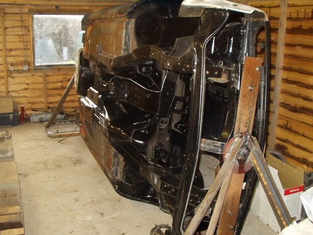

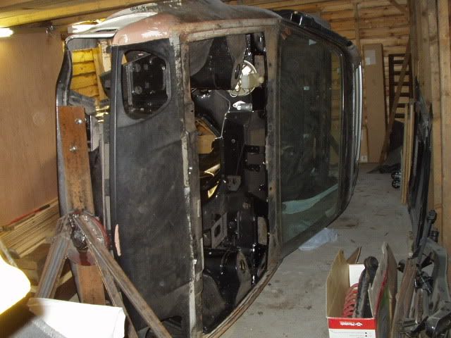

I made mine from lengths of 2inch angle iron, with the centre swivel point (a 1 inch bolt) at 3 feet above the ground, meaning you can tilt it inside the garage. The angle iron is welded to a base, which is an oblong frame 4 feet by 2 feet.
Not that easy to see the spit, but it is easier to make than you think!!
Dave

My spit is pretty straight forward to make if you can weld.
I did post dimensions previously but am happy to dig out the old notebook or re measure is necessary.
Owen
